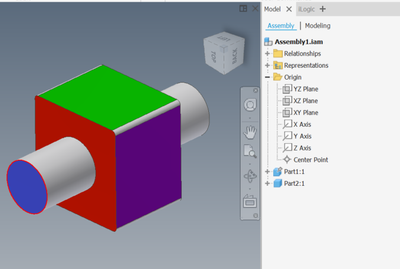

Hi guys,
I want to automate the Coating information in drawing directly from 3d Assy.
I will do below steps.
1.Apply colors is 3d Model
2.Open drawing and place the model
After this I want the code to perform the below steps

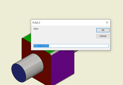

When I run the Code, it should automatically pull the color details and ask the details(user input) like show below
once the details are typed in by the User, The code has to identify and place the flags in the surfaces. the arrow can be anywhere on the surface, user can drag and  adjust as needed.

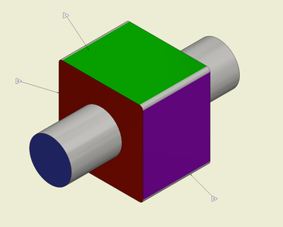

After flag placement, a legend note like below has to be generated (along with Correct RAL code )
SO THE OUTPUT WILL LOOK LIKE THIS

Hi get2dpk,
After having a go at trying to solve this one, I can see why no one else touched it!
Firstly you may want to take a look at the Inventor Beta forum as they are currently working on a Finishes command at the moment, which will be a lot better than anything below.
I hope this helps to at least get you started. I have included some sample files, so that you can see the output and get the symbol that I used. They were created in 2022, please let me know if you need an older version. Here is the rule that should be stored in you external rules directory. Run it on the model first and then run it on the drawing.

	Public Sub AddLegendSymbolsToDrawing()
		' This section takes care of adding the treatments legend to the upper left hand corner of the drawing
		' Order the tags by their tag number
		Dim byTag As List(Of ColourTreatment) = assignedColourTreatments.OrderBy(Function(cT1) cT1.TagNumber).ToList
		Dim sheetBorder As Border = currentSheet.Border
		Dim sheetTopLeftX As Double = sheetBorder.RangeBox.MinPoint.X + 1
		Dim sheetTopLeftY As Double = sheetBorder.RangeBox.MaxPoint.Y - 1
		Dim sheetTopLeft As Point2d = transGeometry.CreatePoint2d(sheetTopLeftX, sheetTopLeftY)
		For Each tag As ColourTreatment In byTag
			' The second string is the Treatment and RAL name combined
			Dim promptStringsTwo = New String() {tag.TagNumber, tag.Treatment & " - " & tag.RALColourName }
			Logger.Info(tag.TagNumber & ", " &  tag.Treatment & " - " & tag.RALColourName)
			sheetTopLeft.Y = sheetTopLeft.Y - 1.5
			' Add the symbol to the drwaing to create the legend
			Dim legendSymbol As SketchedSymbol = currentSheet.SketchedSymbols.Add(treatmentSymbolDef, sheetTopLeft, 0, 1, promptStringsTwo)
			legendSymbol.Static = True
		Next
	End Sub
End Class ']j
Good luck,

james.collinsPWQR2
Hey Pradeep,
I have updated code so it now places the leaders outside the drawing view. Here's the updated code:

The leader placement now looks like below. Please note that sometimes you will get multiple leaders that appear to be going to one face, like on the far left. The top left leader (1) is actually trying to reference the face that isn't shown in the view. This is because there is no easy way (that I know of) to tell if the face connected to the edge is shown in the view. So the end user will have to clean-up a little.
