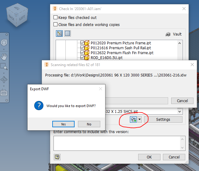

So I have a rule that is set to run with the close document event trigger. This will prompt a user asking if they want to export a DWF of an assembly, but only if that assembly follows a particular filename scheme.
If ThisApplication.ActiveDocumentType <> 12291 Then
	Return
End If
	oJobNum = Left(ThisApplication.ActiveDocument.DisplayName, 6)
	oAsmNum = Right(ThisApplication.ActiveDocument.FullFileName, 7)
	oFolder = "J:\" & oJobNum & "\MECH\REFERENCE"
	If oAsmNum = "A01.iam" Then
		oDWF = MessageBox.Show("Would you like to export DWF?", "Export DWF", MessageBoxButtons.YesNo, MessageBoxIcon.Question)
		If oDWF = vbYes Then
			ThisDoc.Document.SaveAs( oFolder & "\" & ThisDoc.FileName(False) & (".dwf") , True)
		End If
	End If
 This rule works as intended BUT when I check in an assembly and chose to include all related files, the prompt comes up for every file during its search for related files. Any ideas on how to correct this?

This is because the closing document is not the ActiveDocument.
Try this rule
Dim closedDocument As Document = ThisDoc.Document
If closedDocument.DocumentType <> DocumentTypeEnum.kAssemblyDocumentObject Then
    Return
End If
Dim oJobNum = Left(closedDocument.DisplayName, 6)
Dim oAsmNum = Right(closedDocument.FullFileName, 7)
Dim oFolder = "J:\" & oJobNum & "\MECH\REFERENCE"
    Dim oDWF = MessageBox.Show("Would you like to export DWF?", "Export DWF", MessageBoxButtons.YesNo, MessageBoxIcon.Question)
        Dim fileNameWithoutExt = System.IO.Path.GetFileNameWithoutExtension(closedDocument.FullFileName)
        Dim dwfFileName as string = oFolder & "\" & fileNameWithoutExt & ".dwf"
        closedDocument.SaveAs(dwfFileName, True)
    End If
End If

Perfect.. Thanks!
