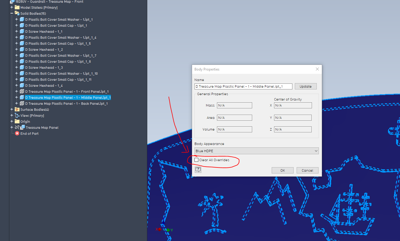

I want to tick the box for clear all overrides on solid bodies properties using iLogic.
I been using oSurfaceBody.ClearAppearanceOverrides() for some year but it seems to not work via code until you go into the solid properties an tick the box while applying the appearance.
Shouldn't this tickbox be a Boolean parameter? true as ticked and false and left unticked?

Tried as a body collection but the code does not work. Still have to manually tick the box.
Below is the code used for testing, even if you skip the second time I override the solid bodies its still not working.

@lyndon,
Try setting the AppearanceSourceType like this:
