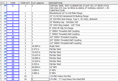

I am trying to change the units of a column to fraction using ilogic
basically access this information through logic

So what i am trying to do is our shop has been asking for a decimal to fraction conversion because they prefer fractional
We would use Item QTY to say how many you need and then i would use unit QTY to show the cut lengths. Unfortunately, frame parts use G_L custom I property and pipe uses PL Custom I property. So cant just pull that custom i property into out BOMs because i wouldnt display both pipe and frame members properly.
^^Unit QTY puts the "in" on only the cut lengths of both pipe and steel frame but leave the other ones "1" without the unit string
So unit QTY is good because it pulls both the frame parts and pipe parts while leaving purchases parts as "1" without any units. So i can use logic to override anything with "1" to be N/A.
But, once i tell it to change it to fractional and give it a unit string it changes the "1" to "1 in" which technically its not even a length. I could do the same to change "1 in" to a N/A but then if we get a 1 in cut length part then it will override it.
My plan was to have logic look down the unit qty column and change all of them to not static, then any cell that has a 1 in it to change it to N/A then it will be constantly checking to make sure its not leaving N/A over something that shouldn't
We often mix pipe and frame members so i cant find a way to make it work

Ok i found a really dumb way to do it
If i pull the G_L value which if the frame member custom iproperty it shows this
then i do a value substation and have it pull PL which is the pipe property into columns that exist
which will show like this
then apply fractional formatting to the column and the substitutions
Now i cant use the logic to put N/A in the blank rows but thats not big deal because it says "Incompatible Units Error" and i cant have N/A stay in there
