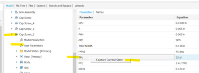

@benedictsweet you can use the ilogic AddContentCenterPart function to do this.
Here I have a CC part that has been renamed in the browser to be Cap Screw_3
In the iLogic rule, I find the CC component and right click and choose Capture Current State () as shown.
I used "by Designation" in this example
That gives you the code to add the component to the assembly. Then you can modify it to add the logic needed to add a specific size based on a condition.
In my example, I just looked at the User Parameters of that component and used Capture Current State on the TPU parameter, to provide the logic.
This example creates a rule to toggle between a #6 or a #10 by looking at the current Thread Per Unit ( TPU) value
Dim Designation As String
If Parameter("Cap Screw_3", "TPU") = 32 Then
	Designation = "No. 10 - 24 UNC - 1/2"
Else
	Designation = "No. 6 - 32 UNC - 1/2"
End If
Components.AddContentCenterPart("Cap Screw_3", "Fasteners:Bolts:Socket Head", "Hexagon Socket Head Cap Screw - Inch", Designation)
I think you can work this into your example.
