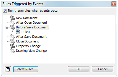

Message 2 of 15
MjDeck
Sorry, there is no way to trigger a rule to run when the sheet size changes.  However, you can make the rule run when you save the drawing.  To do this, use the Event Triggers command (under Manage -> iLogic).  Here's a screenshot:

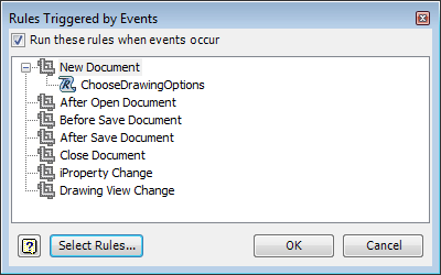

Also is there a way to have the ilogic list box come up after the new template opens?
Message 10 of 15
MjDeck
Here's a version that combines your latest rule with my code for selecting the drawing standard.
You could say that the drawing standard code is a bit complicated.  I did it that way to allow for shorter strings in the text parameter.  It makes the rule easier to use, although the code is more complicated. If it doesn't work in your drawing, please post your drawing file.  You might be using different drawing standards.
To make the rule run when you create a new drawing from the template, use the Event Triggers command (under Manage -> iLogic).  Add the rule to the New Document event.
