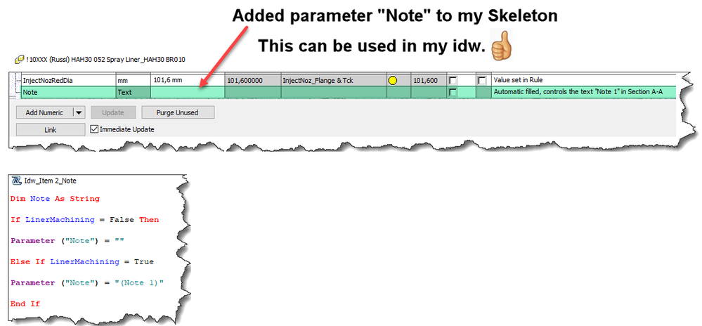

Could someone give me a hint, how to control whether I want text note to be on or off with iLogic?

Found a simpel solution myself, maybe others may have help of the little trick Smiley Happy
