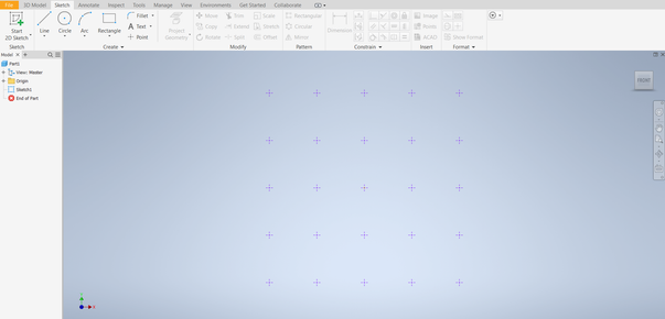

Over the past few weeks, I have been redeveloping the design and repurposing stages for a new project in development within the company Vecta pty ltd I work within. In developing this solution I have turned to using the coordinate system embedded within Inventor 2020 as per an excel spreadsheet. However, with this came limitations as it simply can only create points within sketches as opposed to the solution we must achieve, in being circles of varying diameters within these locations.
As per the following images, the sketch can only assess the XYZ coordinates as portrayed in the following excel sheet.
Instead of locating these center locations of the circles, is there some way I can manipulate the software to instead assess and sketch the circles as per their diameters and coordinates as listed within the excel sheet, all up creating the following sketch.

JhoelForshav
Hi @L_Schwotzer
If the excelfile looks like in your picture, meaning X = A column, Y = B column and diameter = E column.
And the values start at row 2. Try this iLogic rule. Just set oFileName and oSheetName to the file and sheetname of your excel-file.

Message 3 of 12
L_Schwotzer
Thank you very much, worked perfectly

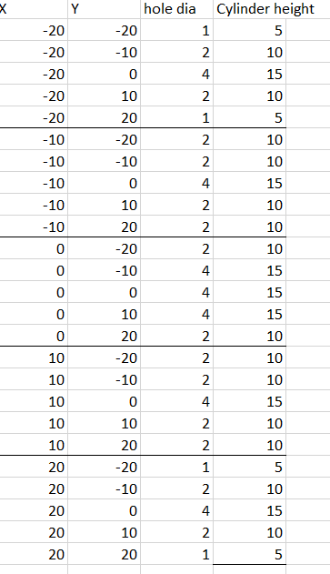

So expanding upon this solution, is there some way I can also allow the excel file to identify specific extrusion heights as per the circle diameters.
e.g. all circles of 10mm diameter to be extruded by 20mm, whilst those of 4mm diameter to be extruded by 6mm

In following this revised table to which includes extrusion values, I was also hoping that these extrusion would be symmetric, versus the one directional default. As you can see with the excel sheet, the heights correspond to the hole diameter and don't vary beyond that detail.

Again it's important that the columns are correct:
A = X-pos
B = Y-pos
C = Diameter
D = Extrude distance
Message 8 of 12
