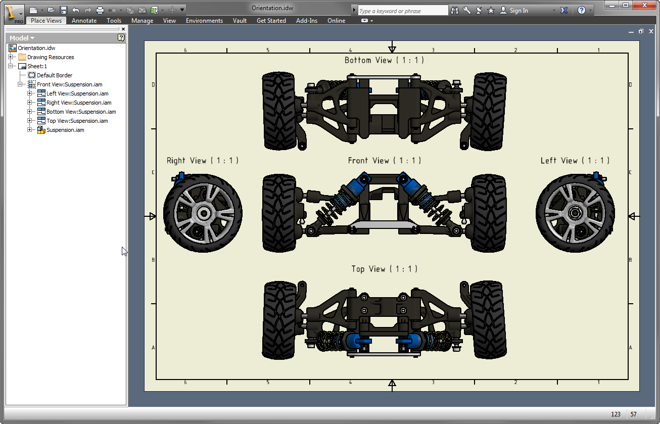

I would like to know if there is a way to have each view name to be set to the orientation names/ the 3D view cube's name. Is there a way to do this without manually changing each one?

Hi jbauer,
you could manage this with a little macro like this:

 bofore:
After using the macro:
The macro will change the name of the drawing view of all view on that sheet.
You can adjust the code and replace the names of the orientation with names you like.
Do you think, this would work for you?

  But It doesn't automatically update what am I missing?
Message 20 of 24
WCrihfield
Hi @marcel.coufreur.  I slightly edit your code a bit in an attempt to maybe being able to help with the updating.  The terms 'ThisDrawing' and 'ThisApplication.ActiveDocument' can potentially be pointing to two different documents in certain situations, so eliminated both terms, and am now using the 'ThisDoc.Document' term to refer to the drawing document in the first two lines, then once I store that document reference to a variable (oDDoc), I use that same document variable at the end, to make sure I am working with the exact same document.  I also included a line to update the drawing sheet itself.  And I am using an Inventor API method of that document to update it directly, while accepting any errors that might arise, and continue.  I am also checking a related Document Setting within that drawing called Defer Updates, and if it is turned ON, that code will turn it OFF.  Give this a try, and hopefully it will update better for you.
Sub Main()
	If ThisDoc.Document.DocumentType <> DocumentTypeEnum.kDrawingDocumentObject Then Exit Sub
	Dim oDDoc As DrawingDocument = ThisDoc.Document
	If oDDoc.IsModifiable = False Then
		MsgBox("This drawing is not modifiable.  Exiting rule.", , "")
		Exit Sub
	End If
	If oDDoc.DrawingSettings.DeferUpdates = True Then
		oDDoc.DrawingSettings.DeferUpdates = False
	End If
	Dim oSheet As Inventor.Sheet = oDDoc.ActiveSheet
	Dim oViews As DrawingViews = oSheet.DrawingViews
	For Each oView As DrawingView In oViews
		Select Case oView.Camera.ViewOrientationType
		Case ViewOrientationTypeEnum.kBackViewOrientation
			oView.Name = "Achteraanzicht"
		Case ViewOrientationTypeEnum.kBottomViewOrientation
			oView.Name = "Onderaanzicht"
		Case ViewOrientationTypeEnum.kFrontViewOrientation
			oView.Name = "Vooraanzicht"
		Case ViewOrientationTypeEnum.kIsoBottomLeftViewOrientation
			oView.Name = "3D indruk"
		Case ViewOrientationTypeEnum.kIsoBottomRightViewOrientation
		Case ViewOrientationTypeEnum.kIsoTopLeftViewOrientation
		Case ViewOrientationTypeEnum.kIsoTopRightViewOrientation
		Case ViewOrientationTypeEnum.kLeftViewOrientation
			oView.Name = "Linker zijaanzicht"
		Case ViewOrientationTypeEnum.kRightViewOrientation
			oView.Name = "Rechter zijaanzicht"
		Case ViewOrientationTypeEnum.kTopViewOrientation
			oView.Name = "Bovenaanzicht"
		Case Else
		End Select
	Next 'oView
	'update the sheet
	oSheet.Update
	'update the drawing, True = accept any errors and continue
	oDDoc.Update2(True)
End Sub
