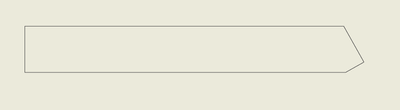

I dont usually work code the drawing environment so im looking for a bit of help 🙂
im bringing in my parts like this
i need to automatically add a sketch to the view ( i can do this)
draw a rectangle around the outside of the part (i cant do this)
constrain the rectangle at .5in to each side like this
Can any of you kind coders point me in the direction of success?
Much appreciated

Alright, after far too long of messing about with different things I've got an example. One that others may be able to explain the math behind (For my sanity).
The below code will place a Centered rectangle on the view at the exact size of the view. An important note with sketches inside of drawings. When the sketch is a child of the sheet object. The 0, 0 origin location will be the bottom left of the sheet. However, if the sketch is a child of the drawing view, the 0,0 becomes the origin of the sketch. If you try to place a sketch object of any kind, using the view location, but have a drawing view sketch. It will appear off the sheet typically.
Now, What I don't understand is the conversions and math I had to manipulate to get this CenterPoint rectangle to be created properly. MY idea would have just been half the view height. However you will see in the code its more like a 1/6 of the view converted, this became some game of me logging and chasing values to make the rectangle at the proper size. To get the extra .5" on the edges, Its just a bit of addition on the end of the creation.

This should give you enough insight to factor in what you'd like to do. If for whatever reason you need to create a rectangle based on the size of the item, rather than the view. Things will get more tricky and require others insight. I wrote like 60 lines before I gave up trying to convert drawing curves into doubles. Became more than I was wanting to investigate without direct experience. What I will add, is this is how my drawing template imports standard views. It then runs two views with an invisible rectangle built off the two views to run through a sorting algorithm. Making sure the imported views do not overlap.
Curtis_Waguespack
@NachoShaw, here's a quick example, using a top view of a basic block as shown.
Hope that helps,
Curtis

J_Pfeifer_
Is that what I was misunderstanding in the math? Similar to how the sheet view reports the sheet location. When creating a rectangle using the size of the view. The scale of this view needs to be adjusted for? As when you place anything on a drawing sketch, its of a 1 to 1 to the sheet scale? If true, I've got to back track and make some modifications to my other programs.
I was using views that get imported from a set size. Due to this importing of standard sized views, I just created an offset and size using generic math. Now that I know this, this math should just be tied to the view scale specifically?

@J_Pfeifer_ , I might not get this 100% correct, but I from memory when we use View.Sketch we're associating the sketch to the view the sketch coordinates and scale are associated with view's coordinates and scale.

Thanks you both for your replies. I was able to to first use Curtis example that was local to the view by using the drawing view size and to be fair it filled what i needed for most part but not 100%, until Curtis added the update which does fill what i need 100% so thanks for that 🙂
I appreciate you both for spending the time to help me out. I added in dimensions and some line styles / colors to complete my task
