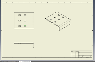

I am looking for a rule that automates placing bisector lines in an inventor drawing for sheet metal punches. I know there is a built in application for automated centerlines, but that doesn't seem to work for rectangular punches. Essentially I want a program that automatically places two center line bisectors on rectangular punches and center lines on circular punches. Is that possible? The end result I'm looking for is the screenshot below:

I see your idea here, however i cannot seem to use the automate center lines command on rectangular punches only on round punches. Even without running the code, it will not allow me to use the center line function on rectangular punches. In order to get a centerline i have to select centerline bisector and click on all 4 edges. Is there a way to automate this?

Im not exactly sure wheat you mean by the origin point of your punch type iFeature is at the center of that rectangle. i want the bisector lines to go through the center of the rectangular punch. Essential i want to automate turning this drawing:
Into this drawing:
For as many punches that exist in the entire drawing.
