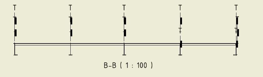

Hi everyone,
I want to attach sketch symbols to the exist sketch on the chosen view by using VBA
Step 1: Create 1 sketch that include small lines. These lines are equal and horizontal constraint of each other. Each line is collinear constraint on the part’s edge
when using the collinear constraint between the line sketch and the part's edge, this edge is at the base workplane where located part's profile
Step 2: Attach sketch symbols (named FRTA and FRTB) to these line sketches made at the step 1
Note that FRTA is used for part which through its thickness from the right hand side to the left hand side
FRTB is used for part which through its thickness from the left hand side to the right hand side
I also attached model and drawing here for further investigate
Many thanks

@thanh.trantuan,
For inserting symbol into view , try below VBA code. Selecting either FRTB or FRTA symbol is depends on your logic.

@chandra.shekar.g
Thanks for your instruction
In this code, the sketch symbol will be inserted to all line sketches within the sketch of the active drawing view. So as you see, when I draw some small line to determine the position of the sketch symbol, I use Collinear constraint between these lines and the vertical projected line in the main structure.
So the sketch symbol are inserted to the projected line also. (picture below)
Could you take a look again this code, sketch symbol just need to be inserted to small line sketch only (see picture below)
Many thanks

@thanh.trantuan,
As the length of line is consistent and measured as 4 cm, try below VBA code to insert on small line.

In future drawing, make sure that line should drawn as 4 cm (40 mm) to insert symbol.
