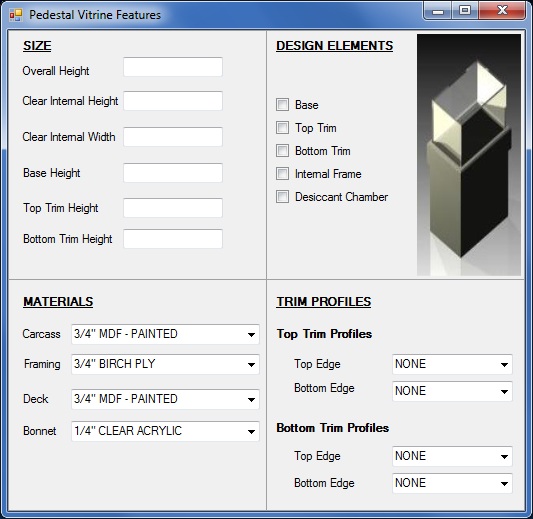

Thank you for your reply. However, I am not using an iLogic dialog with a multi-value list box to set the property value, that value is being pased from the VB form dll to the iLogic Rule code. The reason for this is that eventually my dialog will be much more robust with many more choices such as material thicknesses, sizes, profiles, etc - I need to be able to set these all in one dialog box instead of multiple pop-up dialogs that would be generated thru the use of strictly INV Rules, and the only way I can see to do this is
to design the form in VB. See attached screen shot of the anticipated dialogPedestal Dialog.jpg
