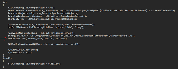

I am attempting, via a plugin I made, to export  Sheet[1] view and all Sketches relating to the view on Sheet[1].  I open the and apply my changes of the drawing Sheet[1] but when I perform the update to apply my changes and do an export I seem to loose all layer information.   What I change via code is I flip and rotate a flat pattern view, do a conditional tweak to an arrow that was placed in the middle on layer 0 if it is point up vs to the side etc.  That part works fine.
When I do the update and wait for the changes to apply then perform the actions to do the DWG export via code using a generated export ini configuration file things were all exporting on the PROFILE LAYER.  I was able to detect and reapply a BACKROUT LAYER and have that come through  but all other layers just seem to come through as PROFILE LAYER in the exported DWG.  For example the Arrow I mentioned is assigned to 0 LAYER but after export becomes PROFILE LAYER, I have not been able to detect and apply OVERBEND LAYER at all via code and I can't seem to figure out how to handle sketches applied manually to drawing Sheet[1] and were set to BACKROUT LAYER.

jnowel
Just a disclaimer, not really that familiar with the language so this might be a long shot.
In iLogic, this portion uses the "nvmOptions.Value"; using "nvmOptions.Add" will result to an error (not sure if in this language, that is OK)
Also, I would assume you are using an existing "ACAD2004SaveAs.ini" instead of the attached "Export_ini.txt".

speterso
Thanks for the reply,  I attempted to use the "nvmOptions.Value" suggestion but I needed to apply a late binding approach to get it to work ie.
NameValueMap nvmOptions = tObjs.CreateNameValueMap();
String IniFile = "C:\\ProgramData\\Autodesk\\AddIns\\AmeriCladRouterTurretAddin\\ACAD2004SaveAs.ini";
dynamic d = nvmOptions;
d.Value["Export_Acad_IniFile"] = IniFile;
This has done something different so might be onto something here.   Instead of the Arrow being on PROFILE Layer now on export it is on a HiddenLayer, which is progress.
OVERBEND seems to come through at BACKROUT now which is good it comes through but it isn't the right layer.  I will try some more things to see why the OVERBEND layer is behaving weird from before Inventor 2026 and .Net 8.
Thank You for your assistance, it does help I would have not thought to set the value like this, I would have thought the Add would have created it but must have required a late binding.
If you have any idea why an OVERBEND would have issues exporting I would be interested in  hearing your ideas.

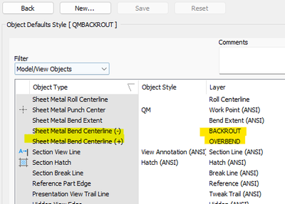

Btw, just to confirm you want the "bend ups" to be OVERBEND and "bend downs" to be BACKROUT?
I think this is easily solved by updating your object defaults.
In the IDW provided earlier, both layers are set to BACKROUT
I think this is due to wrong naming in the feature tree. in your code your kinda expecting some Sketch with "GRAIN" or "ARROW" which is absent in the test IPT file.
On the test file, the Hidden Layer is expected since the current arrow lines are from the embossed features. Flipping the view puts that emboss side on the bottom turning them into hidden lines.
Maybe set the Object Defaults to 0 (maybe you need to check the other hidden edges if needed to be changed as well)
