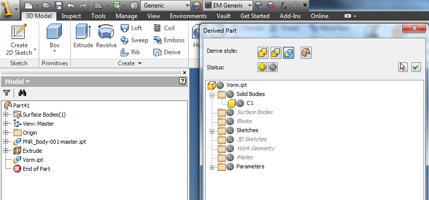

I made a derived part and i"m trying to add a solid body to the derived entities.
I have done this before with surfaces, parameters & sketches.
Now i'm trying to get a solid body.. But this is not going as smooth as i hoped.
For this example oBodycount = 1
        oDerivedComp = oNewDoc.ComponentDefinition.ReferenceComponents.DerivedPartComponents(2)
        MsgBox(oDerivedComp.Name)
        oDerivedPartDef = oDerivedComp.Definition
        For Each oDerEntity In oDerivedPartDef.Solids
            If oDerEntity.ReferencedEntity.Name = "C" & oBodyCount Then
                oDerEntity.IncludeEntity = True
                MsgBox("C" & oBodyCount & " found")
            End If
        Next
So i tested the selection of derived part, because i have two in this part. This returns Vorm.ipt so it's the correct derived part.
Further i have made a test if the solid "C1" is found using a message box. Also this is returning what i want.
But still after running the rule, the "C1" solid is not derived..
How is it that my Entity is not included? But i do get a messagebox that the Entity is found?
