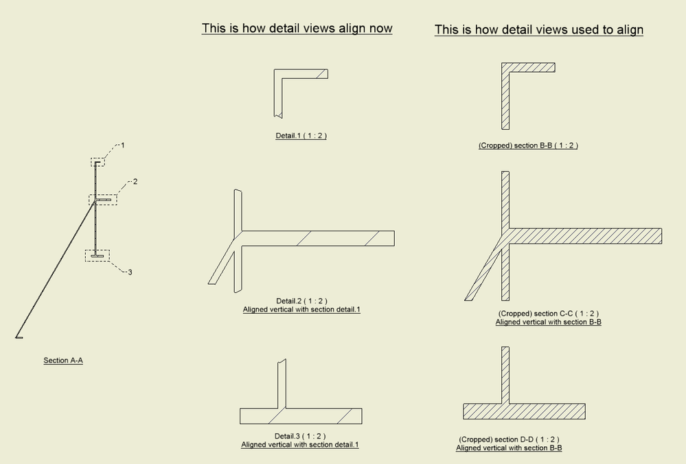

So, Inventor used to align detail views in according to the model. Now it appears it aligns them based on the size of the detail view:
Old drawings that where aligned this way still work. But if one breaks the alignment there is no way back.
Is there a setting i'm missing?

mr_ensing
@rhasell wrote:
Hi
I use some code which I found on the forum.
Thanks.
So that's iLogic code. And it works, but only at the moment you apply it.
I'm working on standard drawings. These get copied and the dimensions of the models change.
The old style of aligning detail views worked great. A super weird change from Autodesk.
(It still works for sections, but detail views now align the center of the view instead of the center of the model.)
