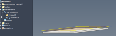

vpeuvion
Hi.
Have you tested the code on iLogic?
The plane is still created relative to the XY plane but is repositioned by the constraint that is applied to it next.
I did some tests on my side, the plane created is parallel to the selected face every time.
