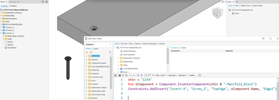

Dim oComponent = Component.InventorComponent(oVin & "-Manifold_Block")
Constraints.AddMate("Mate1", "BOSS:1", "X Axis", oComponent.Name, "BOSS AXIS")
The line above is just getting the component occurrence from the assembly and assigning it to a variable called oComponent.
So if we had this as the assembly:
... oComponent would be getting the component named 1234-Manifold_Block
The next line then uses that variable with the .name property, so that we get the name string from the component to use in the constraint add line.
Here it is in use, in a simple example assembly where oVin is just being hardcoded for simplicity sake.

You could do it something like this, where the curly brackets are used to denote the array path to the component:
oVin = "1234"
oComponentName =  oVin & "-Manifold_Block"
Constraints.AddMate("Mate:7", "Block99", "BottomFace", {"Front Assembly", oComponentName}, "FrontFace")
Where this is the assembly:
Note that to get the syntax, you can find the constraint in the iLogic editor as shown, and right click and choose Capture Current State ( Constraints.Add)
Then it's just a matter of modifying the resulting line to plug in the assembled component name using oVin, etc.
