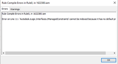

I'm curious if it's possible to access a constraint by name with the new Ilogic API?
My current attempt gives the following error:
MsgBox(Constraints("Mate:25").ToString())
The code here isn't meant to do anything other than let me know if I can access it by name. I have a program that generates assemblies with a known number of parts (known for each assembly, but this changes for every instance of the assembly and it has basically an infinite number of permutations, which is why I generate new assemblies rather than using one with a basic setup)
Currently I don't add a name, but below is the code where I constrain each new part. The basic concept is that if I later change my parameters, I should be able to run the overhead function again, find the constraints by name for each part based off that part name and tell it "This should be a mate. If it is, leave it. If it isn't, change it to a mate."
Does anyone know how to access the constraint through the new Constraints API or do I need to go back into ThisDoc.Document.ComponentDefinition.Constraints in order to access it? My preference would be to use my generation function and the creation function at the same time (i.e. check if it exists, if yes then update, if no then create)

Curtis_Waguespack
Hi @Thomas.Long
Since you are handing the component to the Function, I think you can look at the constraints collection for that component and get the name.
Something like this ( although this example is using a selection set to get the component occurrence)
I hope this helps.
Curtis

Thomas.Long
This isn't exactly what I was looking for but it limits my iterations so much I don't need to worry anymore! My biggest concern was assemblies where I had a few hundred components and I would have to iterate through 600+ constraints over and over again, but this really cuts down on the that!
Honestly, it probably works better than what I expected since I'm limiting the search by component.
