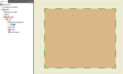

robbeRtek
Can someone tell me how to access the 'feature properties' from an feature select in an drawing view in the drawing environment through ilogic?
or otherwise --> we want to change each curve/edge that's created from an 'surface body feature'  in 'dashed' instead of 'by layer'
Thanks alot

Hi @robbeRtek,
For this kind of task I would probably loop through all the curves inside the specified views & check from what (inside the 3Dmodel) it has been created (feature) with the .CreatedByFeature . Here is an example :
Dim doc As Inventor.DrawingDocument = ThisApplication.ActiveDocument
Dim s As Inventor.Sheet = doc.ActiveSheet
Dim v As Inventor.DrawingView = s.DrawingViews.Item(1)
For Each c As Inventor.DrawingCurve In v.DrawingCurves
	If c.ModelGeometry.Type <> ObjectTypeEnum.kEdgeObject Then Continue For
	Dim e As Inventor.Edge = c.ModelGeometry
	If e.Faces.Count = 0 Then Continue For
	For Each f As Inventor.Face In e.Faces
		If f.CreatedByFeature.Name = "Ouverture1" Then
			c.LineType = LineTypeEnum.kDashedLineType
			c.LineWeight = 0.1
			Exit For
		End If
	Next
Next
Does this suits your needs?

robbeRtek
@WCrihfield  Thanks for reply, for the feature props i was already thinking to the model browser nodes, but it's to complex, so as you say.
@FINET_Laurent  thanks for the snippet, i had already something like that but with a small mistake to actual change the style,
But use the
CreatedByFeature.type or CreatedByFeature.name
 is not use full, i want to change all edges created from an surface bodie, not an solid,
it can be, that we use 'thicken' , sweep, extrude, ... (in surface mode)
So i found an way to do :
the code can run 30 sheets, with 6 vieuws/sheet that need to be changed in 2min on mine workstation, but there is a small bug,...
The last vieuw is not change... maybe you know why?
i can force hardcore to do the last vieuw again but it is not the way to do,...
here is mine code :

FINET_Laurent
@robbeRtek,
Then you only need to switch the .CreatedByFeature method to the .SurfaceBody method (line 12). See example :
		If f.SurfaceBody.Name = "Srf1" Then
			c.LineWeight = 0.1
			Exit For
		End If
	Next
Next
I guess it would be faster than creating many collections..

robbeRtek
Hi
@FINET_Laurent  thanks for your support :
the original code don't work for this case :
An other thing is name 'sfr1'...
Here is the full code, it change 180vieuw/30sheets in +/-20sec what's a higher performence.
thanks alot.

WCrihfield
Hi guys.  The section line in that view will be a SketchLine Type object.  I noticed recently that adding a section line to a view for defining a section view makes that view's DrawingCurves collection get two more objects in it, and both of them are SketchLine Type objects.  When you delete that section line, those two objects go away from the DrawingCurves collection.  The topic came up do to someone adding automated overall dimensions to their drawing views, and that line getting dimensioned, instead of the outer most geometry of the view itself.
Edit:  Also, if you are using the CommandManager.Pick function, and using the DrawingCurveSegments filter, if you click that section line, it will still be a SketchLine, instead of a normal DrawingCurveSegment, which can cause errors if you pre-defined the variable as a DrawingCurveSegment.
Edit 2:  I should clarify that this apparently became an issue with the 2024.2 update, and here is a link to another recent forum response pointing this out.
https://forums.autodesk.com/t5/inventor-programming-ilogic/error-unable-to-cast-com-object-of-type-s...

Thanks! First, create working code, and then scale up the performance. 😉 Here is the full code; it changes 180 views/30 sheets in 5-6 seconds (written in iLogic). I believe if I add it to our app (VB.NET), the performance will be much better.
