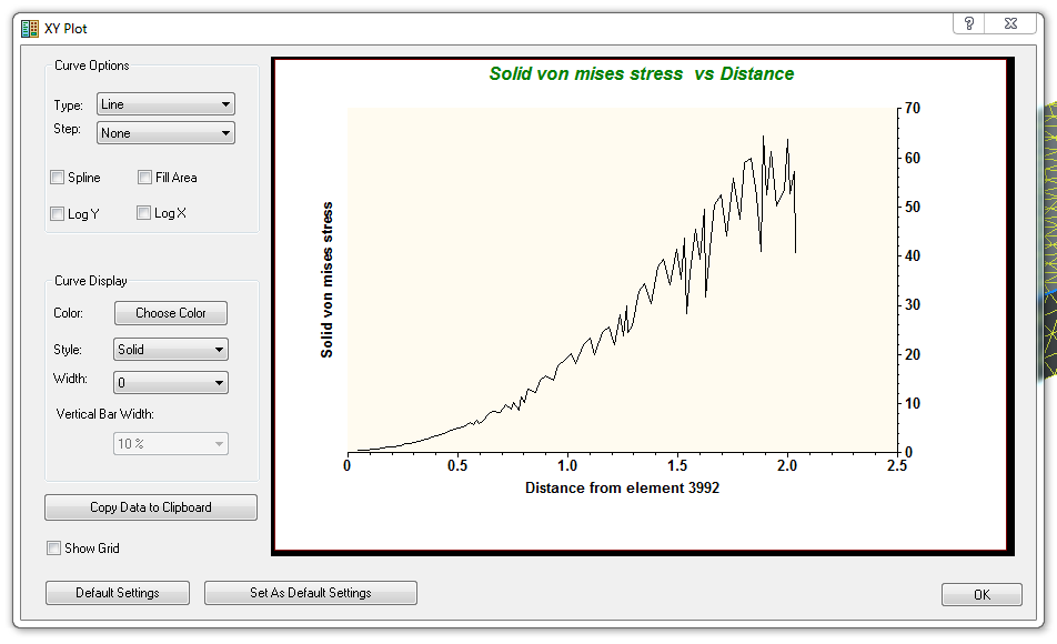

Here is another idea.  It appears that you are not aware of plotting along the edge of a part and are concerned about how the data that is shown to you.  You said "it is not that clear because it has to many values to plot".  Do you mean the data is somewhat scattered when plotted, like this image below?

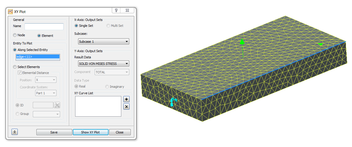

For your reference, below are the settings to get the above plot.
If your concern is with the data being somewhat hard to read, you could copy the information to Excel and add a higher order polynomial trendline to the data.  This trendline will not give you the exact values but should show something a little easier to read.  Below is what I get in Excel to make the data easier to read.  The trendline is orange to make it easier to see.

When plotting along an entity, In-CAD is reporting von Mises stress at the element centroid along the selected entity you are plotting results against.  This is why you are seeing this graph that appears to be scattered.
