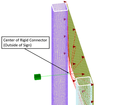

I'm running a random response analysis to analyze a sign post for its back and forth oscillation. I have everything modeled as shells. The analysis consists of around 91,873 nodes 29224 elements.
I have rigid connector connecting the two vertical members to a point placed at the CG location and I am applying an enforced motion type load to the CG point, with PSD provided.
The problem I am facing is, once I begin the simulation the Nastran Output stops at this line and I notice the files don't get updated or size doesn't increase. Waited for more than an hour but there wasn't any update.
What might be the issue?

Hi @jthomas2SNH8G
You have an enforced motion applied to 1 node: the center point of the rigid body. That is not the issue in your analysis.
I do not know what the issue is. Does the Windows Task Manager show (on the Details tab) that nastran.exe is still running and using CPU?
  • If Yes, the analysis is still running. Letting it run is the only suggestion I have.
  • If No, the analysis crashed and forgot to tell you that it had stopped.
I do not understand the rigid connectors and how the vibration of the columns is resisted by the fixed base plate.
  1. Are the rigid connectors attached to 4 edges around the columns, so something that vibrates is mounted on the columns at 4 locations. Or are the rigid connectors attached to the entire face of the columns?
  2. How are the columns attached to the base plate? (I assume with the offset bonded contact).
  3. Regardless, how can the bottom of the columns be vibrated with the PSD while simultaneously held fixed by the base plate? That will create a lot of stress.

Yes I do see the Nastran.exe running in the Task Manager.
I alternately tried running the analysis by having the enforce motion point connected to the sign itself, thinking it might help having relatively lesser nodes connected to the rigid connector and it ran successfully.
To answer your questions on the setup -
1. The rigid connectors are attached to the entire face as if the two columns are connected to something in the middle that is vibrating back and forth.
2. Yes the base and the columns are offset bonded contact.
3. Yes I agree and I am in the pursuit of finding that stress value.
What might be the issue then? Too many calculations required for the Eigen Values?

Hi @jthomas2SNH8G
Somehow I missed in the original post, in the first sentence, that you are analyzing a sign post. Now I understand the model!
But whether you have one enforced motion applied to the sign or one enforced motion applied to the posts, it is still just 1 enforced motion. One enforced motion is not forcing the analysis to solve many extra frequencies. Surely applying the rigid connector to the posts (and making the posts rigid) is not the correct approach, especially since it is the posts that you are trying to design. I think this is how it should be setup:
  1. Apply the rigid connector to the sign. Uncheck all degrees of freedom (DOF) on the rigid body except for the direction of the PSD.
  2. Apply the enforced motion and constraint to the center point of the connector. Only restrain the direction in the direction of the PSD. (You want all other directions free so that the model is as free as possible to vibrate in other directions.)
  3. It does not matter whether the acceleration is in the + direction or - direction. The analysis moves the model equally in both directions (during the frequency response portion of the analysis), and since the analysis is linear, the stress results are equal (and opposition in sign) regardless of whether the + direction or - direction gets "chosen" by the analysis.

Yes sir. I see your point of applying the rigid connectors to the post being the wrong approach.
I've changed that approach and applying to the sign itself.
So let me explain how I have it set up right now, I've numbered each component for the ease of our conversation -
Item #3 is fixed and constrained in all directions.
Item #1 and Item #2 are held to Item #3 by "Offset Bonded" contact.
Item #4 is held to Item #1 and Item #2 by "Offset Bonded" contact.
Item #5 is a external point and the Rigid Connector seen is associating all nodes of Item #4 to this point Item #5.
Enforced Motion is set on the Item #5 (point), with sub-type of "acceleration" and a value of +9.81m/s2.
The load factor table for the Enforced Motion is (0,1)(1,1).

In my step 1, the DOF on the rigid body connectors are related to the forces transmitted to the plate (the face where the connector is attached). The DOF are not related to the node at the center of the rigid connector. By setting the DOF to Tz only, the plate will behave like a rigid plate in Z translation only. It is not rigid in X or Y translation, so it is not quite as rigid and before.
In step 2, you are assuming the enforced motion moves the model or rigid body connector. It does not! The enforced motion moves the constraint, and the constraint moves the model. If there is no constraint at the same geometry as the enforced motion (in your case, at the center of the rigid body), then there is a 50-50 chance that the enforced motion will work.
Now that I think of it, I am not sure what the rigid body connectors will do if the plate end only transmits Z direction forces and if the center node is only constrained in Tz. Will the rigid connectors be unstable? If that happens, you can fully fixed the constraint at the center node to prevent the rigid body from "flying around". Since the DOF of the rigid body is Tz only, only reaction forces in the Z direction will be transmitted to the plate, so the "fixed constraint" does nothing to the analysis (other than provide stability, if needed).

OK. I understand what you mean by your first point and I applied that in my setup, by setting the DOF of the rigid connector to be Tz (direction of my PSD). I unchecked the rest of the DOFs.
I'm confused by the "constraint" you are referring to in your second point. Especially when you say "If there is no constraint at the same geometry as the enforced motion (in your case, at the center of the rigid body)"- Are you saying I must create a constraint for that center point of my rigid connectors and constrain the PSD direction i.e. Tz? (Tz is the back and forth direction, the mode I am analysis via. my PSD input)
In my head I'm thinking if I constrain that node in the direction of my PSD Input how will it transmit the input force to the sign? Doesn't it have to move to work?
Just to show you more clearly how my rigid connector is modeled, the center point of the rigid connectors is outside the sign itself, a point I modeled in.
