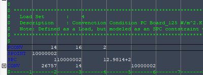

Furthermore I changed the PCONV data in the NAS. file for both convection loads to form 2, which brought the solution closer to what I have calculated, but the results were still far from acceptable.

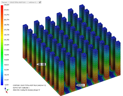

The resulting analysis shows 247 mW/mm^2, which is extremely high

And that is what I am looking for. A heat flux value in the range of 6.250 mW/mm^2 and not 246.829 mW/mm^2 as the analysis indicates.

The heat flux result of 247 mW/mm^2 is the heat flow in the solid. That has nothing to do with the 5.069 mW/mm^2 heat flux from the solid to the air that you calculated.
Can you provide the Inventor files? ( assembly files .iam and part files .ipt, whatever is used by your model) That will provide the answers more easily than trying to interpret the numbers in the Nastran file. For example,
  • Are you using temperature dependent convection coefficient? That would be the only time the PCONV needs to be changes for a different form.
  • Where does the area 0.022461 m^2  come from?
  • What is the total heat flow to the convection faces? That is what you want to compare to your hand calculation of 113.8 W. (Your heat flux of 113.8/0.022461 m^2  is an average heat flux from the solid to the air. You won't necessarily see that anywhere in the results. )
Out of curiosity, what is the hand calculated value of the temperature at the tip of the fin, and what is Nastran calculating? That will be a better indication if the results are reasonable or not.
