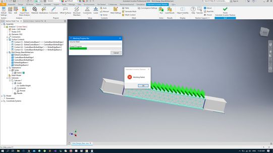

reymart.laranjo
Hi Sohan,
I have tried to model the edge of the middle beam separately. And chose Solid as my Idealization. But it won't allow me to mesh. IT says Mesh Failed.
With Solid IdealizationWith Solid Idealization
I have attached again my model.

sohan.kumar.thiruvakkadu
Autodesk Support
Autodesk Support
Hi @reymart.laranjo
Initially, I too had mesh failed of solid idealization with the model you have attached in your first post. Even if you look at the shell mesh, there were free edges shown up. It seems that the edges on adjoining faces are not properly knitted together.
Therefore rebuilding the model fixed the issue. “Manage > Rebuild All” and “Manage > Updated”. Do this for each part and then with the assembly. Now your solid mesh shall be successful.

reymart.laranjo
Hi @sohan.kumar.thiruvakkadu ,
Works fine now mate. Thanks!
