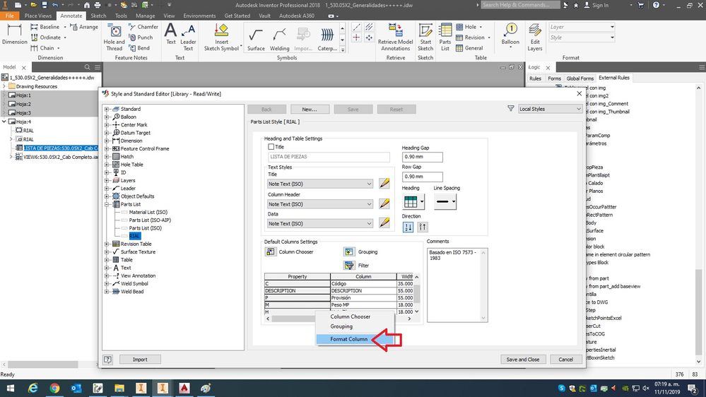

I've added a parts list to a drawing using the api code in the inventor help section. I've then added the mass column to it.
The issue is the mass is to three decimal places and I'd like this be just one. To change this manually you use the apply the units formatting option shown below. Is there a way to do this through the api?
thanks

Hi, I tried to access the property of the column and I have not been successful.
However, I would tell you to try to edit the style of partslist in your drawing template, so when you place a partslist by code it will take the units that you have set in that template.
I hope some of this can help you with your problem. Regards
