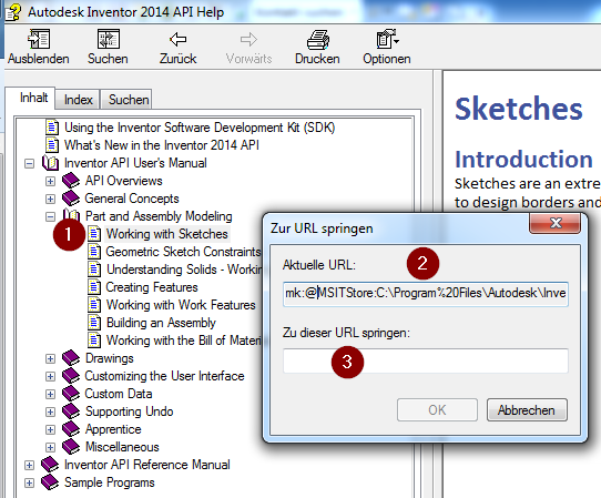

GeorgK
1. right click
2. copy the URL
mk:@MSITStore:C:\Program%20Files\Autodesk\Inventor%202014\Local%20Help\ADMAPI_18_0.chm::/HTML/Sketch_Overview.htm
3. paste the URL and jump to the URL
Hope that helps
Georg
