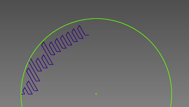

After being struggling with the original code provided by Owner, we had got some changes into the code, although it still doesnt fit.
Please find attached the png file with the result, which is awful, but we keep trying. My trigonometry is a little bit rusty so I need to recall some things... apart from the logic itself. Any idea will be welcomed. I am trying just to make all the points within the circle, following the basic equation for a circle. My bottom limit is the X axis and my vertical limit us the Y axis (just one quarter filling)
We only want to fill a quarter of the circle....
This is our actual code used:

Message 10 of 12
Hi there,
We keep trying.
After some more brainstorming we have got something really close to what we want. please see picture.
RIght now the only thing we want to do is to continue with the y axis. We managed to stop there, and we are struggling to get the part of the code that will allow it to finish it. Please feel free to comment.
We should thank Owner before for his suggestion. Code is based on his, although is quite dirty at the moment, partially works.

Owner2229
Hi, I've got some time to look at your code and here below is my result:
It's not complete, but it's a good start.
You've been overly complicating it. You dont need to check if the line is out of the diameter. You need to compute the lenght of the line from the given point to the circle and then round it to match the "Pitch".
PS.: Don't call me "Owner", it's just a nickname. I'm Mike, as it stands in my signature 😉

There've been some issues with the 3th line, so I've changed it to be under 30° instead of 60° and wrote some exeptions in the "oLineLenght" function, starting with "If First Then". It might be better to start drawing this complex line from right instead of left. It would then measure the 4th line instad of the 2th line, so the 3th line wouldn't cause the issues.
Consider using "Accept as Solution" / "Kudos" if you find this helpful.
