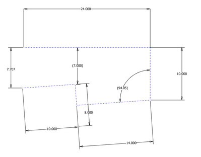

I have a fairly complex situation where multiple configurations cause two points to fall below a minimum depending on the configuration.
Part file attached (Minimum Dim Example.ipt)
Please see "Sketch1" and notice my comments on the parameters.
d6 and d3 are the driving dimensions. Neither d10 or d11 can fall below 1" and whichever one is less needs to be set to 1" but I still need to drive the angle dimension because sometimes it is set to 180° and d10 and d11 are ignored.
The easiest thing I think would be if d10 and d11 had a "minimum" allowed value of 1", I could set the angle to 1° but once d10 or d11 get to their minimum, the angle would just stop there so maybe it ends up being 85° even though it is set at 1°. For the second case, d6 would get set to 180° therefor it would not matter.
Here is how to see what I mean:
When you first open the part, you can see that d11 = 1". Perfect. Take note that d6 = 94.05° but doesn't matter at this moment.
Now change d3 to 10". Now d10 & d11 are both too high and due to geometry change, d10 now needs to be set to 1" since it will be the closest point to the horizontal line.
So now, d6 needs to become 77.75°
I hope this makes some kind of sense...

This is really cool but my issue is different. I made an example here. Thank you.
https://forums.autodesk.com/t5/inventor-ilogic-and-vb-net-forum/control-sketch-dimension-limits-max-...
