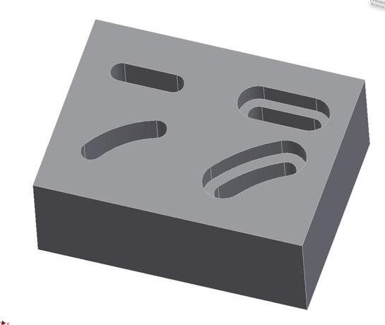

•slot hole/ arcslot hole withleveloption
•stepped bore like a reversed shaftgenerator
•specialsheetmetalbore

Hi @michael_marx. Can you clarify a few things for me?
  1. What are you asking for in the "specialsheetmetalbore" example? I'm not sure what the picture is trying to communicate.
  2. What are you asking for in the "standardized hole patterns similar in mechanical" example? It seems to me we can create any of these patterns now with the Circular and Rectangular feature patterns. No?
  3. When you say "place and link holes with all sorts of points (sketch points, edge points, workpoints)", placing holes on Sketch points and Workpoints is already possible. What do you mean by "edge points"? Can you post an example picture of this?
  4. Can you post a sample picture of what you mean by "place and link holes [...] where the points not on the insert plane"?
Just trying to understand your idea better Smiley Happy thanks!
michael_marx
Hi DRoam
1. i want the same thing in the hole dialog than in cut feature inside sheetmetal to have always perpendicular cutout also if the hole isn´t perpendicular.
2. i want to do those patterns inside the hole command as done inside mechanical. And how can you do a midpoint referenced pattern?
Only if you first create a hole
3. have you ever tried to click to an edge point to insert a hole?
4. link holes to points which are not on the same plane! for example backside holes should be on the same position than frontside holes and i only want to draw one sketch!!
