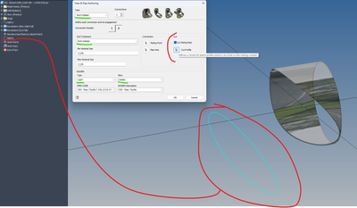

Trim Pipes to other Pipes for welded connections.
I wish Inventor Tube and Pipe could Miter pipe connections and also create Saddle Connections.
Inventor Frame Generator can do it with structural.
It would be nice to be able to choose the outside surface of the main pipe (or inside surface for a stub that is set-in and goes through the hole) and then trim the other pipe to it.

t_filip
@FProcp - This is similar solution as for @shallN6L5D. I use Butt Welded parts for this. The only downsize of this solution is, that the pipe is divided for two pieces. One from CC and the pipe itself.

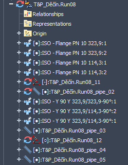

I've created similar thing as you do, so have a look at the pictures:
This:
is made out of these parts:
and the pipe itself is automatically cut like this:
You also can create branches with long piece/pipe/tube which goes deeper to the pipe which is cut.
We've created buch of these parts for various angles (even tangential).

t_filip
@FrancPro Holes has been cut by the Butt Welded Branches I've placed on the pipe.
At this category:
you have to define the part of the family like this:
To define profile which you want to cut the main pipe by. See the green underlined categories. Red - the sketch (no circle, but projected geometry - some kind of egg-shaped spline in this 60° branche case).
You can "steal" some from the libraries of Inventor. I don't know them, we've created our own.
BUT, from my point of view, this is the most complicated part to define and to work properly of whole Inventor Content Centre...
So, good luck!
