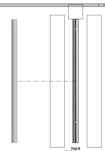

Project either the Projected-Left  or Projected-Right, and you will  obtain the Back view.  No need for another base view.
OR...if you dont want the side view between the front and back views..
Create your front base view, then create a back base view, and finally select horizontally align.  They are then linked together.

Sometimes I want to show the front, both sides and the rear, but in order to get the rear I need to start a new command.
I want Inventor to know that I've already placed a side view and offer me the rear view off of that.
As seen in the image, the first three rectangles are what I want, but I also want the rear view to the left of the left view.
Currently I just get a second left view.
I don't know why I would need two left views so it would nice if we were offered the rear instead.
