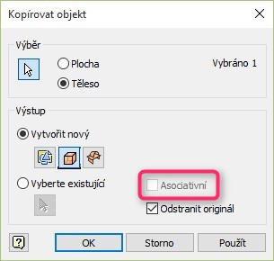

MikeSmell_ADSK
User would like the following improvements made to the Copy Object command.
1. The copy object command should retain associativity with the parent feature or body.
2. The copy object command should be expanded to offer support for model edges and work features.
Tags (1)

I would like associative copy body in multibody part
patrickberry
I'm just running in to this today.  There are of course workarounds by copying the geometry to a surface and stitching it, but this tends to be a bit clunky and runs the risk of translation errors, especially when dealing with complex surface geometry.  Plus, I can never get associativity to work properly, which defeats the purpose.
