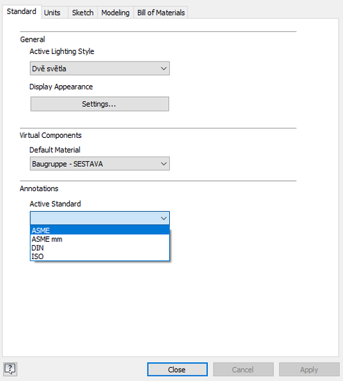

Dear Inventor Wizards
I usually work in metric (mm) and all my dimensions use this as the standard unit.
But when adding dimensions directly in the assembly environment under the 'Annotate' tab, the units appear in imperial (see screenshot).
Can anyone point me in the right direction to change this?
Using Inventor 2021
Thanks in advance 🙂

If you didn't get this dialog after hitting Annotation:
Then try the Document Setting under Tools:

seba555k
Awesome - That did it 🙂
Thanks.
