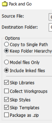

@WillL84
In general - when you Pack and Go an assembly - the Design Data and the Templates folder is not needed.
I recommend fully defining each and every sketch.
Any time you see a lighting bolt - Update and resolve the issue immediately.
