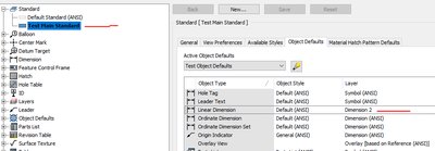

Here is showing one standard with a test object defaults and linear dimensions being on dimension 2 layer.. and another with a different active object default and the linear dimensions are on dimension layer (not dimension 2)..
Then I can have 2 different templates and one uses "Test Main Standard" and the other uses "Default Standard (ANSI)" and my layers are as expected and I don't get any errors when creating a new drawing..
