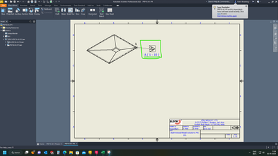

Dear Inventor users,
                                         I am trying to create a detail view & it works fine no problem at all. But I want View Identifier below the detail view as shown in 2nd Screenshot.
But unfortunately, I don't know how to do this automatically.
So, please tell me the right way to do this.
Thanks in advance...........

It's set in your style manager:
Rishi-Bhardwaj
it doesn't work for me....
why, I don't know
johnsonshiue
Hi! You probably need to recreate the Detail View. The new setting will not be propagated to the existing views.

Rishi-Bhardwaj

@Rishi-Bhardwaj
In the image you shared, the setting you are looking at is for Base view.  Select Detail view from the pulldown, and then also make sure the Visibility is set to ON.  See image below.

Rishi-Bhardwaj
Thanks alot sir.
