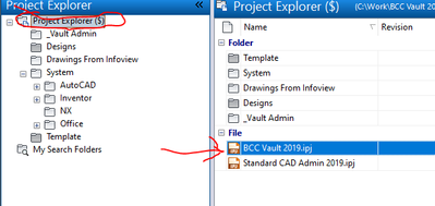

Have these arrows in Inventor under the Vault tab and it concerns me. Is this normal or should it be something to be concerned about.

It may mean that the file was changed by someone on a different machine, and then checked into the Vault.  So now your locally saved copy is out of date.  It would only cause problems if the changes that were made to the Project file affected your paths or libraries... something like that.  Without knowing who changed it or what they changed, it's difficult to say if it will cause any problems.  In any case, a Refresh from Vault should get you the latest Vaulted copy of the project file.  Simply Right Mouse Click over the project in your browser and select Refresh File.

G.S.III
We don't have Vault administrator really. There is only 3 total cad people been just kind on us to figure it out.
Do believe this is an issue below but don't know how to repair it.
Shows the project in vault is at the root
But in Inventor under vault map it shows it is somewhere else.
When i try to change that get this error
Don't understand what it is talking about? How could the project not have a workspace?

Dominik.Janshoff
The Vault root directory deviates from the Inventor Working path.
You must specify the directory, where your project file is located in the Vault and not the Inventor working path. The project file is located in the root directory ($) of the vault. The Inventor working path shlould be an sub folder in the root directory.
You should check your content center file directory. I think with your current settings you can cause some bad issues with your content center files because the directory is not set correct. The yellow tringanle in your screen shot.
  • Change the working path in the project file to your working path of Inventor. I guess "$/Systems/Inventor".
  • Set the project root to the $ folder.
  • Create an libary folder in your root path with the name "Content Center Files".
  • Change the directory for the Content Center files in the project file to the content center directory
  • Map the Content Center Files to this directory.
All Information without guarantee and at your own risk. It is hard to provide an solution based on some screen shots.

G.S.III
They are in systems/inventor
Message 8 of 10
G.S.III
Thanks to everyone, Think I am getting somewhere now.
No Red Arrows now
This mapped to root now and has content center files linked
On this didn't understand that is was mapped .\System\Inventor always thought it would be mapped to somewhere on the local computer drive like the C Drive
Seems to be working correctly now. Please review and let me know if that looks correct.
