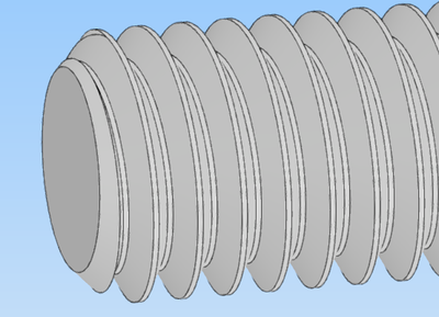

If I import this step file of a threaded rod that is 6"
What is the easiest way to make it 4"?  8"?
I dont see where we are able to send an attached file but here is the link.
I am looking for a best practices
What I do know is split the threaded rod at the chamfer and then extrude and then combine the chamfer but it sound like way too many steps.
I guess I dont understand why I cant just drag the face of the solid 2 inches out or in.
Thoughts?
https://www.mcmaster.com/3313N26/

You can use direct edit.. You just need to select the end and the chamfer face.. Enjoy!!

Are you downloading the one with modeled threads?
If yes.
Model your own iPart.
