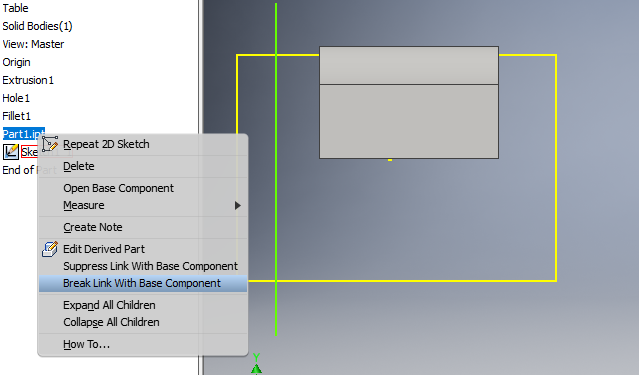

I am confused by how trim works. I have a sketch I inherited from somebody else, some ad hoc shape. I would like to modify it by trimming a couple of lines. I add a horizontal line which crosses the sketch in the point where I want to trim it, but inventor lets me trim only the line itself, I don't find any way to trim the closed shape instead

Xun.Zhang
If I understand correctly, you are talking about derived sketch from anther part. If so, you can't trim the derived sketch.
Please break the link and then the derived sketch is free to trim.

hi, thank you for this. I did not have that in the menu, it looked like a self standing sketch already. See the attached screenshot. The green line is added by me, to trim the pink shape, but it didn't let me. I noticed though there was that "projected loop" in the menu, and that does let me break the link, and now everything works!
Xun.Zhang
Ah, in this case, you have to break the loop profile before make any change.
Hope it helps!
