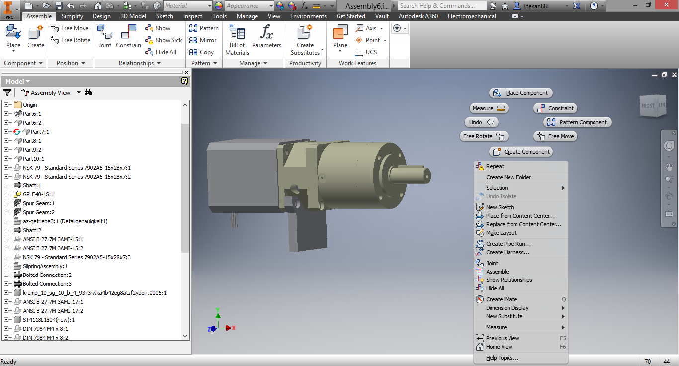

Hello guys,
In my projects I was having too much parts, therefore I wanted to isote some parts which I want to make changes. But after some change I faced with problem. Now I want to 'Undo Isolate' nothing happens. When I recognise that there is no 'Undo Isolate', I closed the program without saving.  But when I opened my project again, I had only 3 parts left like before. I put my screenshoot into the attahcment. What should I do?  Please help me.
Thank you in advance

What version of Inventor are you running?
Have you installed all Service Packs and Updates for your version of Inventor?
I cannot reproduce the issue you describe.
You might have to select each Component and reset Visibility.

I think it's from "nesting" isolates.
I get a similar problem if I need to do an isolate on a chunk of stuff just to find the parts I want to isolate - it won't go step-by-step back, it will only undo the last isolate.
After I get burned a couple of times I will set up design views so I can get back to the "default" view I need (the default defaults always turn on every work feature and any unconsumed sketches and whatever else will make your day worse).
So 1.) make a design view for the visibilities you need as a base so you don't depend exclusively on "undo isolate" and 2.) go to the idea station and ask for more than just a single "undo isolate" (you'll need to come up with a better way to explain it).
