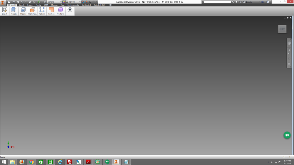

Hello. I need help badly.  I have a file a customer sent me.  Its an SLDPRT file and when I open it nothing shows up, but then a notepad opens with code? Please help I am going to loose this contract if I can not work on it this weekend 6/2/2017

I have Autodesk Inventor HSM 2015.  It will only allow me to upload 3 files.  I have more if I am able to email you the file?

JDMather
You can right click on folder containing all files and select Send to Compressed (zipped) Folder and then attach the resulting single *.zip file.
You should be aware that this is a public forum, so if the files are proprietary - do not attach them here.
The files were created in SolidWorks 2015 - so you would need Inventor 2016 to convert them.
I think you could convert them through https://myhub.autodesk360.com/ , but not sure about that - give it a try.
(convert to STEP *.stp to open in Inventor 2015)
You will be out of luck for drawing files (*.slddrw).
