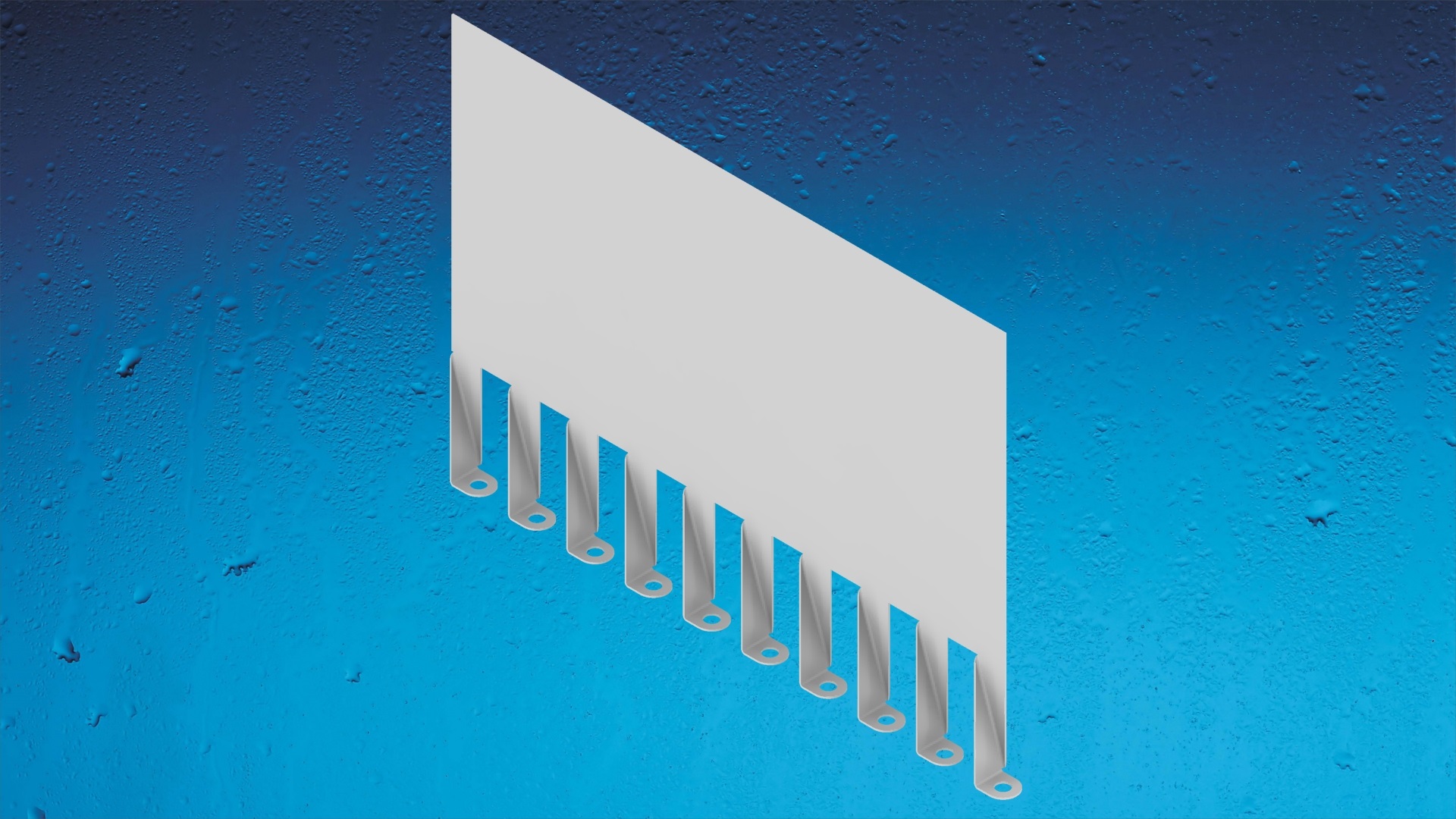

I need to create the following sheet metal part in Inventor:
You can see that it has "legs" that need to be twisted to a certain location. Is there a way to do this in Inventor?

It's possible, and the way I'm showing is just one of the ways to do it. It all depends on exactly how you want to end up. I did this in Inventor 2015, but I didn't use any of your dimensions (FYI).
I've also attached a 3D PDF of it.

This looks like it would work great for what I need. It's not perfect, but gets the job done. I'm using Inventor 2014 service pack 2. Is there any chance you could save it to that version?
Message 5 of 8
BromanSillito
I was able to duplicate this part, but the problem is that the flat pattern doesn't turn out right. I would really like to be able to get an accurate flat pattern from the model as well.

Message 7 of 8
BromanSillito
The reason the flat pattern didn't turn out right is that I have to have the holes in a specific location when bent (see dwg above). I couldn't get the holes in the right location without changing the bend angles, and when I did this the flat pattern was wrong. I ended up just using a loft to accomplish the twist and then on the flat pattern I cut the legs off and replaced them with flattened legs (since Inventor can't flatten lofts). Not the way I would have liked to do it, but it got the job done.
