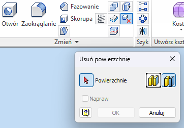

piotrekdoro94
What software have been used to make the cast and do you have access to it? It might be worth it to install it if you have an executable lying around or to try and download a time-limited or legacy version if it is available in order to retrieve all the features.
When it comes to modelling complex parts for metal casting (I'm assuming that's how the part will be manufactured) I would recommend trying a multi-bodied workflow. My general advice is:
  • identify how will the part be molded/unmolded. Pay attention so that all surfaces are tapered in a correct direction. There should be no surfaces parallel to the direction in which you will slot in your model and cores and absolutely no overhangs
  • make sure you round all the sharp edges or the molten metal might not fill them properly,
  • the model you have access to might or might not be scaled to account for shrinkage of solidifying metal, so take that into account,
  • try to model the cast part in its raw state first (the way it will look right after unmolding), apply all the features that are the result of machining after you are done with your raw cast,
  • simplify your model into several bodies. You want them to intersect. Taper them properly, subtract them, delete leftover pieces of solids (use command in the image below), add them to create a single solid and apply fillets in this order
  • you might have to use some lofts. If they get too complex you can divide them into several simpler profiles. Use guide rails generously, remember to check if your loft features didn't result in too thin/thick walls or you will end up with some holes/internal cavities. Remember that with lofts you can change boundary condition to tangent to avoid having to apply additonal fillets in places where new loft profiles are situated.

johnsonshiue
Hi! To remaster the part, I would remove unnecessary detail first. This casting part has a lot of filleted edges. I would use Delete Face/Heal to remove the blends. After that, the body should be much more simplified. The dimensions can be measured more easily.
If you are moving from another CAD tool to Inventor, consider using GoToInventor (https://www.iti-global.com/interoperability-products/gotoinventor/) by ITI, an Autodesk partner specializing in translation services.
