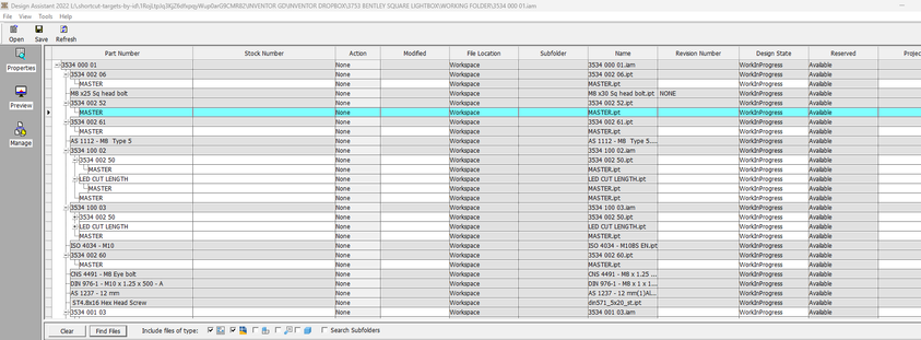

Hello all.
So as you can see from the SS below, I want to rename a couple of files from an assembly using Design Assistant, but its not letting me do anything in the action column. The files that are greyed out are the ones I cant rename! It never happened before, and its only happening now.
I am on Inventor 2022.
Files are all Work in progress and I dont use Vault at all.
What could be the issue here??

Click on "None" cell. You should get a cursor menu where you select the option you need.

Uhh, I know that of course. Thats how I always rename files, but now the right click context menu isnt opening at all, and for the files it is opening up, the option to rename is greyed out.
Message 4 of 22
dan_inv09
Did you get any sort of error message when you opened the assembly in Design Assistant?
It's very picky about everything being properly resolved. "But that stupid little bolt over there has nothing to do with what I am trying to work with!" Tough! Sometimes I just want to delete the parts it is complaining about - putting them back in a re-constraining everything is much less trouble than trying to figure out why Inventor thinks there is a problem with that part (and in the end, most of the time the only way to "resolve" the screwy parts was to delete them and reinsert them anyway).

It is hard to tell what's happening with the files. I thought - maybe their status was changed to "Read Only" in Windows Explorer file's property but a quick try didn't make any difference to the ability to rename the file in DA.

Perhaps non-migrated file(s) somewhere in this assembly?

That's it, I believe. I have opened an old assembly in DA and all non-migraited files were not available for editing.
I don't know how OP could overlook it. The warning message that files need to be migrated pops up straight away.

Hi! Yes, I believe this is due to unmigrated files. To persist name change, the affected files will be saved. And you will not be able to revert back the change. Please migrate the files first. Then all Design Assistant tasks will be available.

Yup everything is properly resolved and constrained so I am sure that wasnt the issue.
I renamed each file manually by doing "Save and Replace" since design assistant wasnt helping. But I still need help with that since I am gonna be using that assembly alot for couple of other projects.

Nope, all files are migrated to the current Inventor version that I am using.

Nope, it wasnt the migration issue, each and every file is migrated. I ran the task scheduler with migration task, just to be sure and tried again. Didnt work

This is just a hunch. And maybe a long shot (if indeed all your files are migrated, including content center files)
But can you try creating a new IPJ in which the workspace directory path is not too long?
And relocate the files there? Then try again in Design Assistant.
edit: if that is indeed the case, consider turning your folder (if that is some kind of DropBox or similar) into a drive letter to shorten the path.

@jnowel tried that too. The directory I workl from does indeed has a long path (working from google drive), so i figured that might be the issue, manually copied as well as pack and go the files to some local drive on my PC. Didnt work with either.
