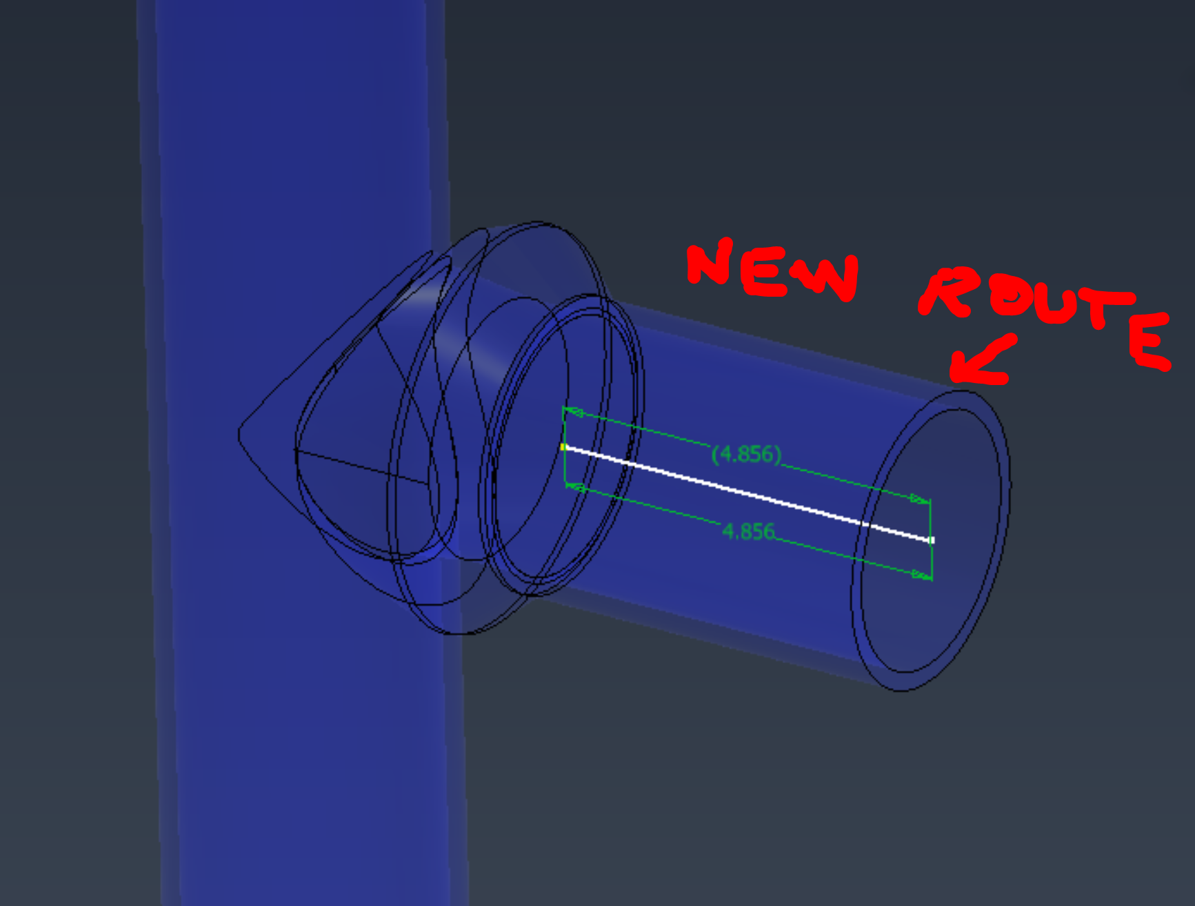

Hi
If I place a threadolet from content center, may someone explain to me how tu make the pipe conection?
480 Views
CGBenner
@luisalejandroff2010 Welcome to the forum!
When you say pipe connection, do you mean the branch pipe coming off of the olet fitting?  If so, this will be done by creating a new pipe route, and using the olet as the starting point for that route.
