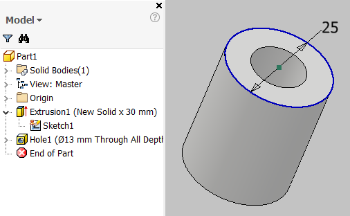

Create a 25mm cylinder as shown.
Create a 13mm hole in the cylinder as shown.
Attach the resulting *.ipt file here.

TheCADWhisperer
@Anonymous wrote:
ok done!
No, it is not done.
You used an Extrude feature, not a Hole feature as shown in the image that I attached.
When doing threaded Holes it is absolutely critically important to use the Hole feature tool.
Also, as you have found, you should have MS Excel installed.
