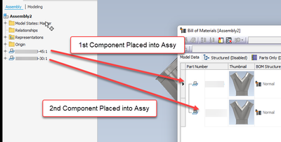

Can you please show the Model Data tab for me. Maybe I wasn't too clear on what I was stating before, but just incase there are images attached. I just want to make sure we are talking apples to apples here lol:
Image below is 2 components placed in, just 1 after the other:
Next, opening the BOM to see they are in the same order as when initially placed:
Then, I manually re-arranged the parts in the assembly:
Finally, checking the Model data tab, but doesn't swap the order:
So, with the ones that work for you, does the Model data tab match the model browser for those assemblies?
Also, for the one that doesn't work,  does the model data tab show a different order and what you are seeing in your messages boxes is what is listed as the first item in the model data tab?
I know this may seem redundant, just wanting images for proof is all.
