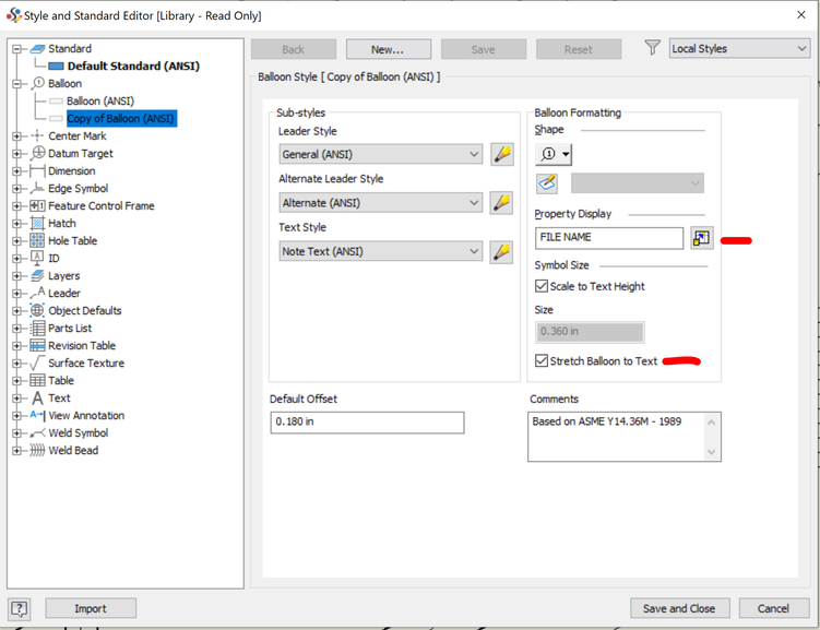

@kobus.erasmusZ65VM
I just did an expirement with Balloon Style, by creating a new style, and setting the property to File Name (just to test it).  Make sure the box is checked to stretch to fit text.  I did not add this to anything in Object Defaults, but you could if you wanted.  It works to make the balloon stretch to the text, so this might be closer to what you wanted?
Chris Benner
