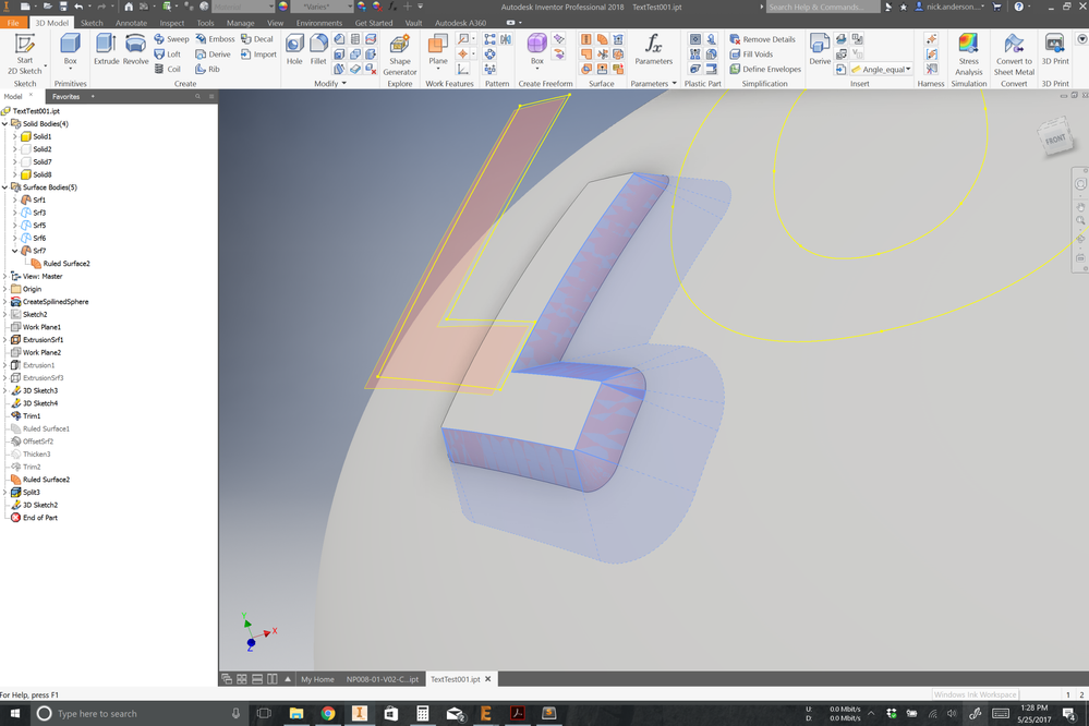

Solutions like these at best emboss the text either normal to the surface it's projected on, or normal to the sketch it's projected from. Leaving huge undercuts. At a minimum I need to be able eliminate the undercut by tapering the embossed feature, like extruding a prism with a draft angle. The magical tool that I would really like would be able to control which edges get drafted how much (though, I can't even begin to imagine what that tool would look like). This is so that I can achieve that 1 degree draft relative to the z axis below the text, but also I could have a sharper upper edge of the embossed text (ideally I could control how sharp this is).
I've been playing with creating a surface of the text face at the embossed height above the spherical shape, and using the ruled surface tool, which allows you to control the angle it does it's thing (sorry, using surfaces is very new to me, as is the lingo). Then using that surface to split the thickened body I made for the embossed feature. I think this will work, but I don't have control over the the angle coming off the different edges, but I can live with that.
I feel like this must be a somewhat common thing that the plastics peeps are doing. There's no way I'm the one pioneering this. I'll post more about what I'm doing once I have a clue of how to explain it without sounding like a newb.

If I were you, I would use Ruled Surface. The command was designed to tackle requirements like this. In some cases, you might want to use edge-edge Loft Surface if Ruled Surface does not generate satisfying result. If you want, feel free to send me the part directly ([email protected]). I can take a look and see if there are better workflows.
