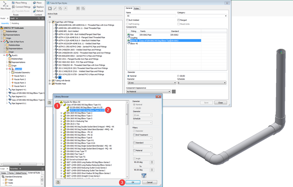

Here is the content center test family.
Here are the results when selecting the UPVC member. Don't just select the family at point 1, expand it and select the exact member you wan't at point 2. It will list all the members matching your fitting type, angle, diameter.

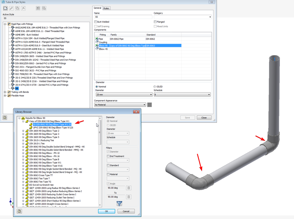

Here are the results with SS fitting from same family.

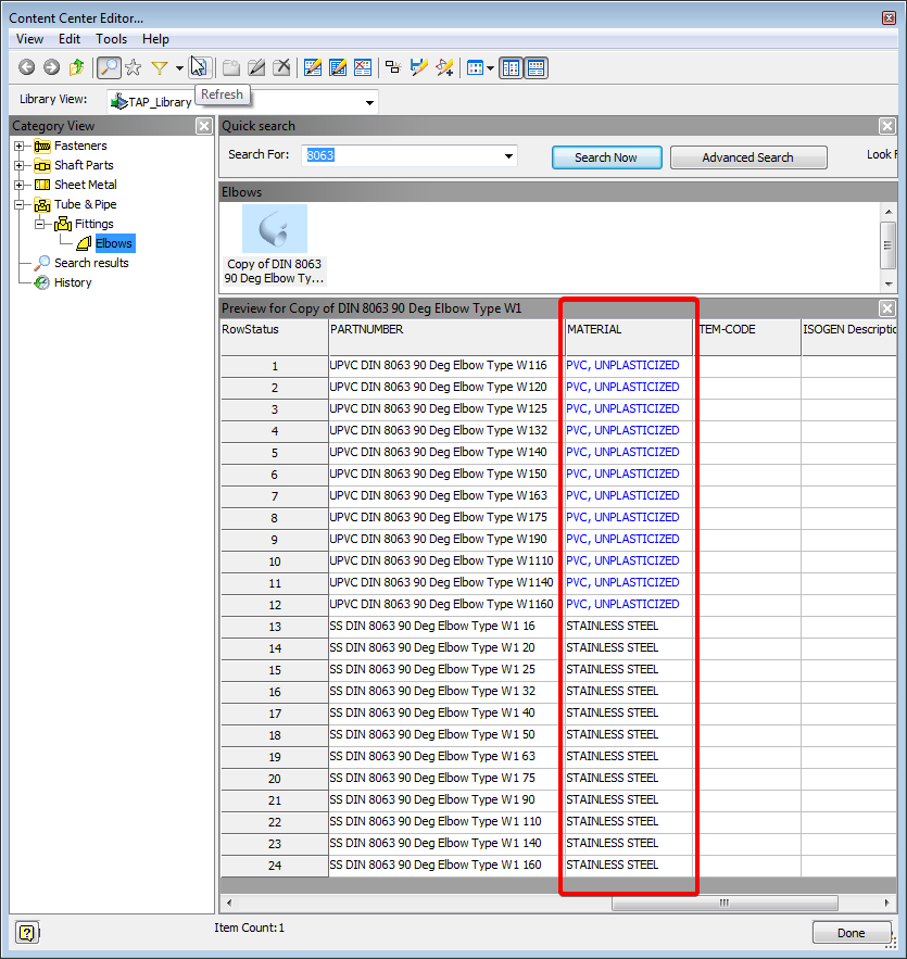

Each member has a unique ID (hidden by default) but that is what tube and pipe style uses to identify the exact member to place. If you edit your family table in excel and you un-hide all rows you can see the unique ID of each member.
I have exported the style to xml and it seems it reports the elbow by "family ID" then "member ID".
Last part after the # is the member ID I have in excel family table.
